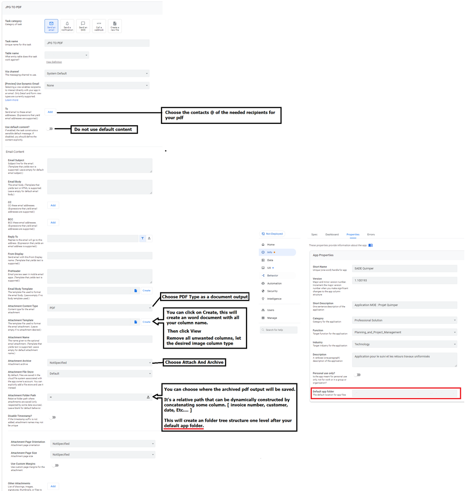

The issue I am struggling with: App users add photos to the app (before and after job photos and also job sheet photos) I need to attach these photos in PDF format to the accounting package when invoicing. I could add a Bot to trigger when the photo’s are added but I don’t know the steps to convert JPG (photo) to PDF? and then save them to a folder (or another field if required) or email them. Its the converting of JPG to PDF that I just cant work out

As far as I know you can’t change an image to a pdf file using the platform.
What you could do is to add the image inside a pdf from word/docs/html/etc template.

Ok, so you know the basic to make it happen.
You can’t direclty convert image to pdf but As @SkrOYC just said. [ He sends you usefull link ]
The “trick” is to make an word template that will insert your image’s into a document then attach and archive a pdf output. [ making a full screen image layout can be tricky ]
Bellow how to configure the task. ( if you can see it )
If you are still stuck i will create an AppDemo
Yahoo!!! Thank you so much - this worked perfectly! Much appreciated
I’m glad you succeed and learned a new trick.
