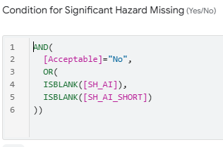

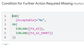

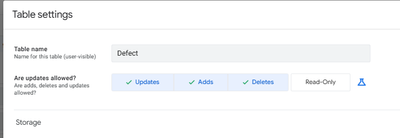

Gonna need to see the bot, action, and slice configs. Any table Are updates allowed? expressions? Need to see those, too. Also security filters.
No its just Google Sheets
Action
Slice
Bot
1minManager_3-1737561484156.png1minManager_4-1737561519295.png1minManager_5-1737561567549.png
