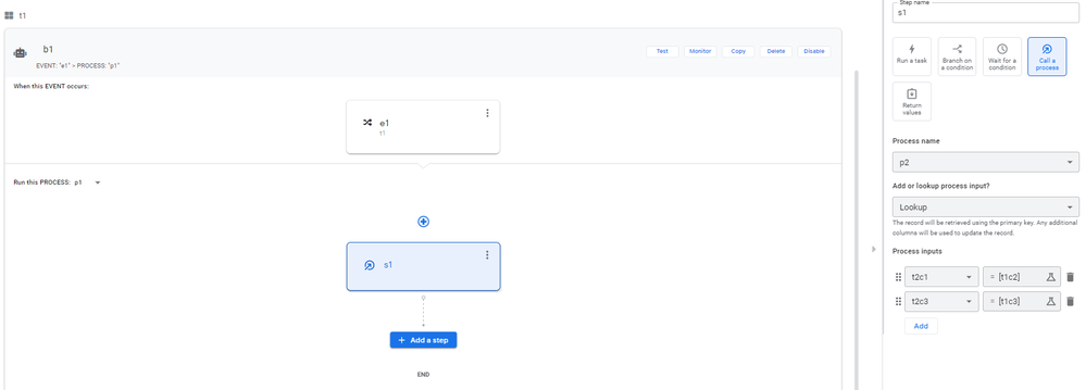

Thank you for the clear communication. Somehow I missed the โ€œCall Processโ€ step type before. I have spent the morning playing around, reading forum and reading support documentation however I am having some difficulty understanding how the Process (p2 using your nomenclature) processes โ€œProcess Inputsโ€. e1 triggers b1 which calls p1. p1 invokes p2 via a step, โ€œCall Processโ€. This step passes data into p2 via the โ€œProcess Inputsโ€. The Process Inputs pull from the columns of t2. I assume the Process Input formulas here are to use variables from t1. I think I understand all of that.
So the question is: How do you reference / use the Process Inputs inside p2? I have seem some posts that indicate these are held in variables named after the processes or steps however I have not had much luck with guessing the proper syntax. The Process Inputs from the step (s1) in p1 need to make it into p2, to s2 and into itโ€™s associated action. If it helps I previously wrote actions to act one t2. When called from inside t2 they pull data from t1 and act as desired. I potentially donโ€™t need any data to pass to p2 via the Process Inputs however directly connecting the existing and working actions to p2 did not work.

@prithpal I am also having a tough time wrapping my head around the Bot-Event-Process-Task automation. I am not sure what row I am changing using the Data actions (set and delete) when I am in b1 that is activated by e1 and running p1 and use a step that could call p2 which runs t2 which runs a2.
I am guessing it can be set by the Process Inputs with the Lookup option?

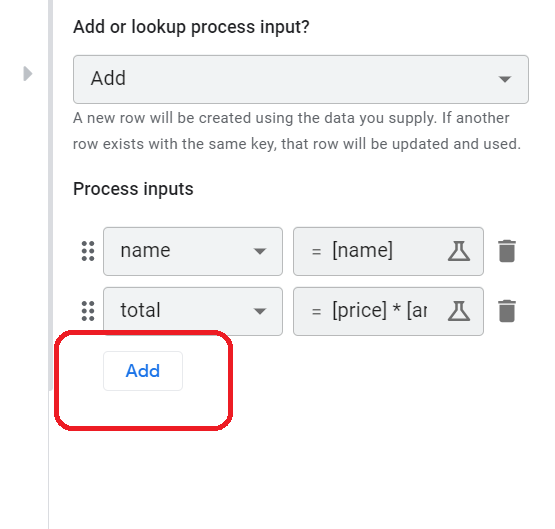

from s1 (while you still have access to the row from t1), you can click โ€œaddโ€ to pass in values for t2c3
t2c3 = [t1c3]

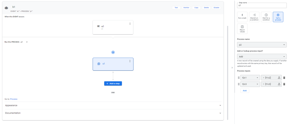

I have changed s1 from โ€œlookupโ€ to โ€œaddโ€ per your instruction.

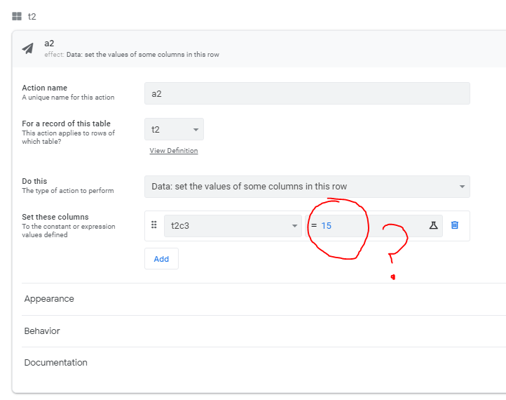

How is this used in a2 to actually set the value of t2c3 using t1c3? I canโ€™t seem to reference p1, s1, p2, or s2 from inside a2. I can reference t1 but it defeats the entire point of passing a single value in via s1 and would require some filtering it find the correct row.
I meant hitting the โ€œAddโ€ button below in the โ€œProcess Inputsโ€ and then do
โ€œt2c3 = [t1c3]โ€

@Zhifeng_Lin Please correct me if I am wrong but s1 already has "t2c3 = [t1c3]โ€ as a Process Input.
I know I need to change a2 from โ€œ15โ€ to something but the questions is to what? I had โ€œ15โ€ as a placeholder to test everything else. How do I call the Process Input from s1?

I have no idea exactly what is going on here but I am going to make some random statements. AppSheet can correct me if they would like. I tried both โ€œAddโ€ and โ€œLookupโ€ in s1. They both work however โ€œAddโ€ seems to require you to have inputs for all column data (even though some of it may not be used). The Process Inputs seem to be their own variables that can be named the same as any other variable but are not actually the same variable. The key Process Input variable (t2c1 = [t1c2] here) is being used to identify which row of t2 the process p2 acts on. Additional Process Inputs seems to be placed in a temporary variable that happens to have the same name as the columns in the table that is being acted on.
