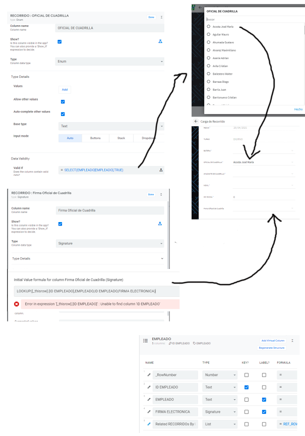

In this form I choose two employees with ENUM
To the Crew Officer with SELECT (EMPLOYEE [EMPLOYEE], TRUE) and to the crew assistant with SELECT (EMPLOYEE [EMPLOYEE],
[STAFF OFFICER] <> [_THISROW]. [STAFF ASSISTANT], TRUE)
I donโ€™t know how to show the signatures

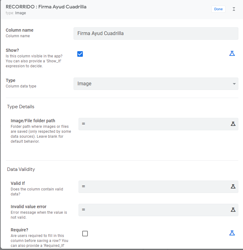

I canโ€™t get it to work!
I need to bring the signature of the selected employee in the โ€œcrew officerโ€ field in the โ€œcrew official signatureโ€ field
You can set the column as signature and add intial value as above mentioned expression.
Rifad, when I enter the formula it gives me this error
You should change the Column type ENUM and set as REF column base type and select table EMPLEADO Table.
Then change the formula to-
LOOKUP([_THISROW].[OFFICIAL DE CUADRILLA],EMPLEADO,ID EMPLEADO,FIRMA ELECTRONICA])
This message appear
I find it difficult to understand the relationship between both tables
You should put the initial value formula
in signature column
Signature as image type and signature
employee table structure
What is the column type for official de cuadrilla?
For Column OFFICIAL DE CUADRILLA
Column Type: ENUM
Base type: Ref
Source Table: Empleado
Suggested values or Valid if put this expression- EMPLEADO[ID EMPLEADO]
Did you do like this for OFFICIAL DE CUADRILLA ?
