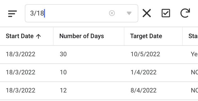

Search bar is ignoring the locale set for the device, sheet, and app tables, and seems to force interpretation only in US locale.
This behavior is evident in searching for Date values; while the locale is set to dd/mm, the search bar interprets it as mm/dd, leading to erroneous or no search results.
Here results are shown only if mm/dd is used, which doesn't match the locale's date format.
Upon using the user's locale, no results are shown.

I'm working on this one. I should have it fixed in a few days, and then rolled out over the following week.

Still working on it, was trickier than expected.

The code's in, we should deploy it tomorrow and roll it out over about a week.

I'm not sure how would you do that, but while at it if possible, please try to review this date issue in the code in general. I believe this mismatch would be manifested in other parts of the app, not just the search bar.
The app editor for example is nowhere reliable and behaves at will. Sometimes it displays the date interpreting the locale correctly, and sometimes it does not.  I guess, some backend servers behave differently than others, maybe. Thanks again!

Unfortunate update here, it looks like my fix here caused performance problems in search, so we had to roll it back. I'm looking into fixes for that.
