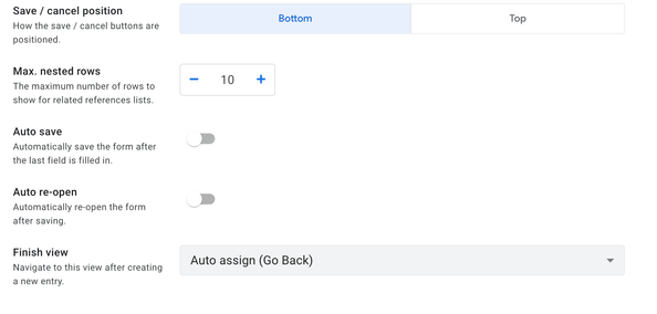

I didn't have this problem a week ago.
I tried with different SO (Android, IOS, Windows, Mac) same problem.
In UX > Views > Finish view
I tried with....
and..
Same problem

I tried different views and same problem
Captura de pantalla 2023-10-19 a la(s) 10.28.36.pngCaptura de pantalla 2023-10-19 a la(s) 10.37.32.png
