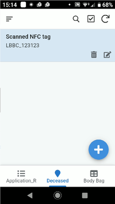

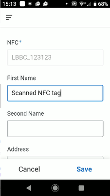

This works perfectly on my Android phone.
It starts the App, opens a new record, and fills the NFC field with the contents "LBBC_123123"
If I save it all is well, the record is created correctly....
Here's the BUG....

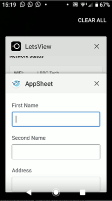

If I now click on the (+) button to add another field, the NFC field is *MISSING*
I've tried this with different tables, different NFC settings (visibility, require, edit, etc).
Nothing works.
However, if you close Appsheet using the Android OS ....
and restart the App, the NFC field comes back!
Surely that's a bug.

NFC symbol is now *missing* from *all* NFC fields.
Users cannot now scan NFC tags into fields
Workaround
  • Terminate the App from Android interface
  • Run the App again
  • Open the record to be edited
  • NFC Symbol is now restored to near the NFC fields
