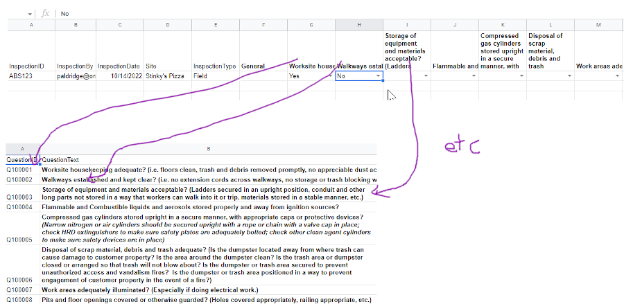

Building a 50 Question Questionnaire: can column names be returned as values??
Context: I am building an app for field technicians to conduct a site survey of places they work. The app is essentially a questionnaire with about 50 Yes/No questions ("Was site clean?" "Was PPE available?" "Was there a fire extinguisher?" etc). I have made each question its own column. A little unwieldly (especially on the backend), but AppSheet can handle it well enough with page breaks and stuff.
We would like the app to trigger actions if the answer to any question is No. Ideally, we want to create a Followup record that is a child of the Inspection row that references the question, the follow up action taken, etc.
Problem: While it is easy to force the user to manually create a child and manually choose the question to follow-up on, I am hoping to automate this a little and have a child row created for every No answer. For this to be usable, I want the automation to populate the Question as a value in the Followup row. The problem is that the Question is a Column Name, not a value in the row.
I have a mapping table that gives each question a QuestionID, but I don't see a way to get any expression/action/automation to read a column name and match up to the value in another table (Image below that hopefully shows what I mean). Like, check for a No value and then return the name of that column, or, select a list of columns from a row that have a value of No.
Even if I can't autopopulate a row in the Followup table based on a No answer, I would love for the user to be able to at least select from a list pre-filtered to only the questions they answered No on if they have to manually create a followup row.
Now, I am my department's himbo, so I can accept if the answer is "This is a really dumb way to do this, and also not possible." I'm just wondering if there's some way to meaningfully use the answer to a question (the value in a column) to record that question in a row elsewhere.
Obviously, it seems like the smarter play is to have a parent Inspection table that has no questions and a child table that is connects an InspectionID to a QuestionID to an Answer value but I don't know how to recreate a simple questionnaire format that would iterate through every question in the Question Table to create the child rows (this would also make reporting pretty whack I have to imagine, although the way I have it now is going to look like a mess if anyone tries to export).
Hope all that makes sense! Am I approaching the problem wrong? Is there any hope for this beautiful meathead of a designer??

I have built (still building) an Inspection app recently, something like yours.   Here is an example of what it looks like:
Just to get straight to the point, from an app perspective, it will cause you all kind of headaches to list your questions as columns.  Don't do it!  Instead start off with a table like you show at the end with Question ID and QuestionText.
I also recommend having a parent Inspection table and a child Inspection Results table where the questions are COPIED for the specific inspection.  Each inspection needs to have its own set of answered questions AND you need to be able to "remember" which questions were part of the Inspection at the time it was completed.
This row based approach will also allow you build a way to manage the Inspections through the app itself for things such as amending questions or adding/removing questions.  You can't do that in a column-based approach without physically changing the app tables and redeploying the app.
Good luck!  Feel free to reach out with questions

Oh wow, that's a clever way to do that and solves the problem I was having with the user experience of dealing with child rows instead of columns. Thank you for the inspiration and advice!
Actually, one question: are you having AppSheet create a child row for every question when the Inspection is initially created? Like, they hit "Create New Inspection" and it autopopulates all the child rows and then they just scroll down and answer as needed?
Yes, basically that is what I am doing.  In my case I actually have a Template table where the list of questions are chosen as child rows.  I could have several templates.  When the "Create Inspection" happens, a template is chosen along with other details including location.  Upon Save,  the Template Questions are used to pre-populate a set of Inspection Results rows - one for each question - with the question result initialized to some default.

I don't know your need .... but I will assume you have a list of questions,  need to create several Templates and then use a Template in some questionnaire.
Below are the tables I would use for this basic structure in any kind of questionnaire app.  It can be easily modified to fit different kinds of questionnaire types. (NOTE columns names are for example only).
I have assigned ID's to make it perfectly clear where the REF's are coming from.  Depending on your use cases, there may be many additional details needed at any of the table levels.  They are represented as Option columns.
Questions Table
List of all questions with at least the question text and an ID.  But it may also contain OPTIONAL columns for:
  • categories to classify the question
  • question answers OR possible answers for multiple choice kind of questions.  These MAY need their OWN table depending on the app.
ID Question Option 1 Option 2 Option 3
a1 Question 1 text
b1 Question 2 text
c1 Question 3 text
Templates Table
Main parent template table that specifies a generic Template, name and optionally active dates or other template specific details
ID Name Option 1 Option 2 Option 3
d1 Template 1
e1 Template 2
f1 Template 3
Template Questions Table
Child template table with list of questions for EACH template.  Template is a REF to the Templates table. Question is a REF to Questions table.  Other optional columns might specify details about these questions for THIS template.
ID Template Question Option 1 Option 2 Option 3
g1 d1 a1
g2 d1 b1
g3 d1 c1
h1 e1 b1
h2 e1 c1
i1 f1 a1
i2 f2 b1
i3 f3 c1
Questionnaires Table
Main parent table shown to users to interact with questions.  Template column is a REF to the Template to be used.  Optional columns for other specifics such as dates, maybe accuracy details, completeness, etc.
ID Template Name Option 1 Option 2 Option 3
j1 d1 Survey 1
k1 e1 Survey 2
l1 f1 Survey 2
Questionnaire Questions Table
Because each questionnaire must be interacted with independently of all others, they each need their OWN set of questions that can be changed independently of all others.  SO... the questions from the chosen Template MUST BE COPIED from the template list at the time the questionnaire is created.  Then columns are used to record actual answers and optional columns for other details needed.
ID Questionnaire Question Answer Option 1 Option 2 Option 3
m1 j1 a1
m2 j1 b1
m3 j1 c1
n1 k1 b1
n2 k1 c1
o1 l1 a1
o2 l2 b1
o3 l3 c1
I hope this helps!!
