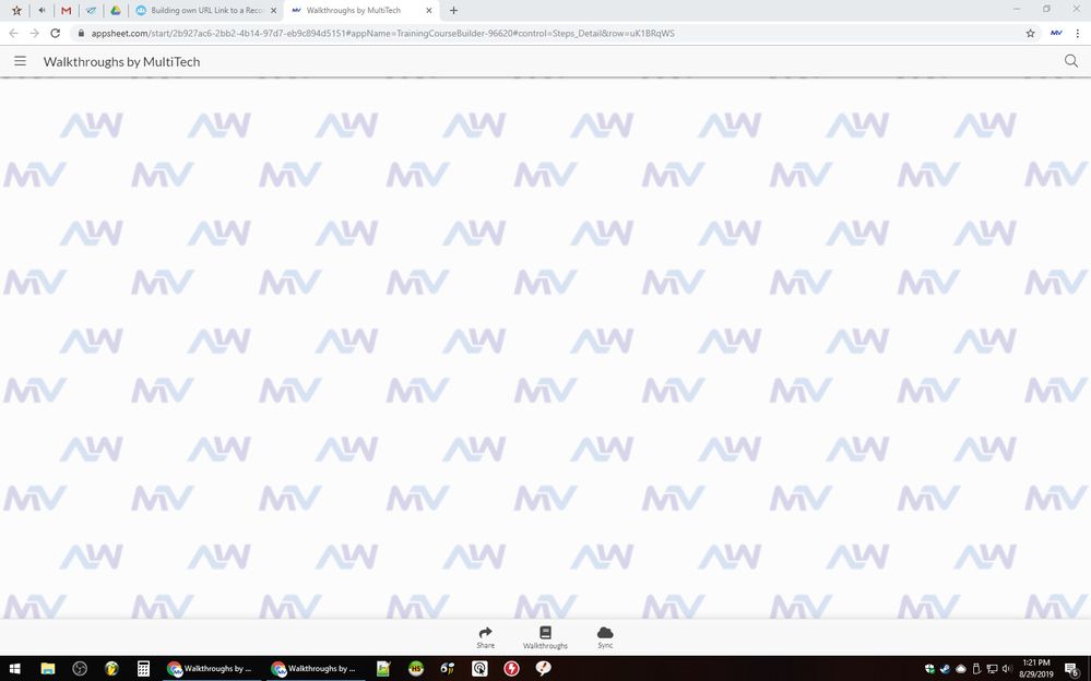

For instance, I’ve created a deep link that should launch you into a record
https://www.appsheet.com/start/62d2b34c-dfa1-4b33-a87d-9050ea22ce5c#appName=WalkthroughsbyMultiTechP...
Yet I’m betting if you tap that it takes you to an empty screen.
Yea, same for me, that sucks! I’ve been able to get link back into a View in the app, but not exactly to the detailed individual Meeting/Member/Role View that I need. We WILL figure this out! Thanks SO MUCH for looking into this, will be very useful when sorted! I will keep you in the loop as soon as I figure anything out, plz do same.
A big issue I’m having is that when I do get Linked back into the App, even with a Sliced View, Users are able to then click on Navigation Bar Views and get back into the entire App. This wouldn’t really be a problem if everyone was supposed to have App installed, but the way I’m just trying to gather Contact & Confirm data, it is.
