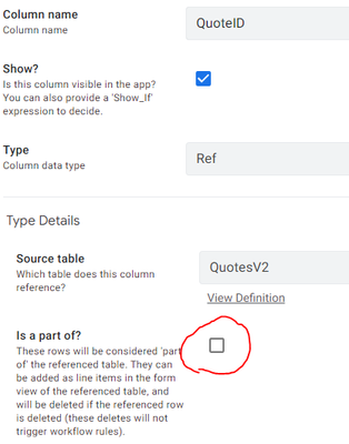

There are two things I would suggest for this problem.
The first and easiest can be done if your data structure is related to your other tables with a Ref, following the 'normal' Master->Child->Child->Grandchild etc system where each other table further down the chain is related to the previous table.  If this is the case, then ticking the 'Is a part of' option when setting the Ref will cascade all the deletes to the other tables once the Master record is deleted.  This is the preferred way.

If each of those child tables has a field that is a Ref to your Master table and each Ref is set to be 'Is A Part Of', then I cannot understand why it won't delete those child table records on deletion of the master record.

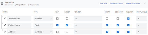

The parent table(Locations) has a column [Project Name] set as a Text type - (see image below).  The child tables all have a column named [Project Name] that is set as a Ref type to the parent table.
You are using a value that somebody types in to set the unique key of your master record?
How does this value get put into the child records?  Do they type it in there as well?
For the parent table, the user opens a form and manually types in the project name.  After they save the form, a group action triggers that adds a row to each of the child tables and automatically sets the project name as the one the user entered in the parent table.

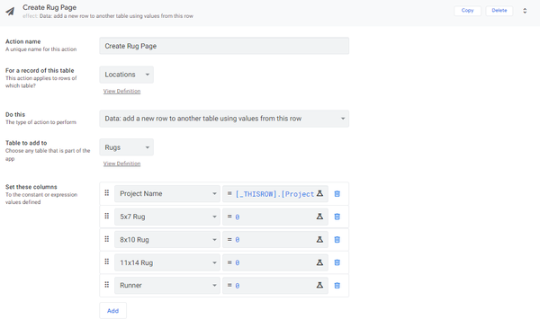

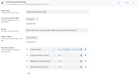

@scott192 - Here are the screenshot of the actions to create rows in child tables.  The key column in each child table is Project Name.  The formula I am using to set Project Name is [_THISROW].[Project Name].  All these create actions work perfectly.  Upon testing, only the Wall Art child row is deleting properly with the parent.  The rows from Accessories and Rugs will not delete even if the other sheets are removed.
Action 1:  Group (triggered when form is saved from parent table)
Action 2:  Create Accessory Page
Action 3:  Create Wall Art Page
Action 2:  Create Rug Page
