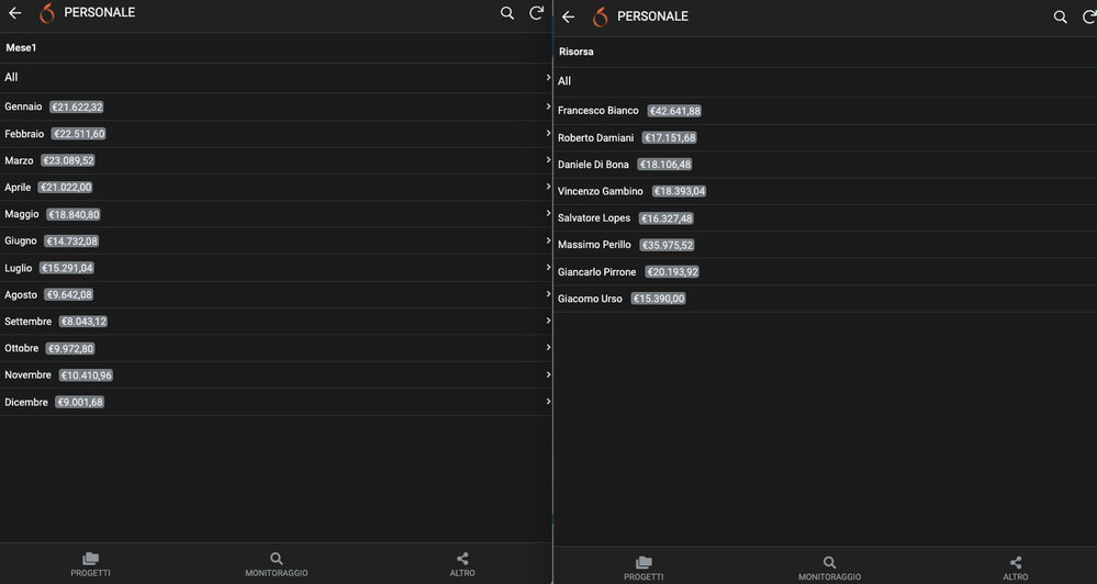

In the first screen I have used the formula SWITCH(MONTH([Periodo]),
1,“Gennaio”, 2,“Febbraio”,3,“Marzo”, 4,“Aprile”, 5,“Maggio”, 6,“Giugno”, 7,“Luglio”, 8,“Agosto”, 9,“Settembre”,10,“Ottobre”, 11,“Novembre”, 12,“Dicembre”, “”) but It’ doesn’t work because the second image is the detail of “Gennaio” and as you can see the total of Gennaio should be 21.622,32€ divided for each person
On the contrary, If i use the formula MONTH([Periodo]) the function “group by” works correctly

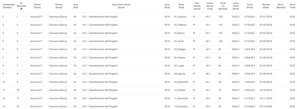

Also post here your table’s schema (All the columns on that table and it’s column type)

This is the UX config for this View. Column [Mese1] is the virtual column with the app formula, [Risorsa] is like “employer”
and this is the structure of DB

If you read my second post probably you will understand. The problem is that the next view not respect the group if I use the formula SWITCH(MONTH([Periodo]),
on the contrary It respects the group if I use the formula MONTH([Periodo]) but i’d see the month in the extended version like “January”
It says that [Mese1] is type Number. Is that right? It should be the one with column type Text and the formula you posted above:

Yes, I tried and If I turn number type in text type It lose the correct order of mounth but the group works correcly… maybe we are close to the solution…
It should be Text, Number doesn’t makes sence.
You could add numbers.
Instead of ‘January’ → ‘1. January’
