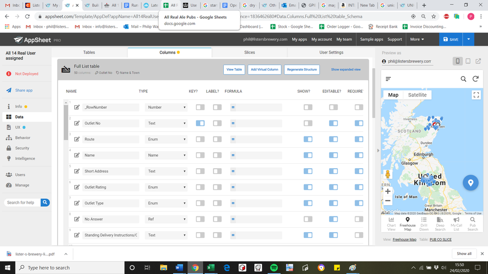

CSV file downloading blank when based on a slice
I have slice of a main table that is created using a user defined table so they csan search for different type of outlets int he data. It always downloads a blank csv file though with just column headings.
(I posted this previously and Steve asked me to post a screen shot of my table but I can’t find that original post)
So here it is. thanks Phil
0 10 1,382

I would like to see the Slice definition and the View from which you are trying to activate the CSV download from.
Hi John,
Below is the slice expression. Also are screenshots of the views. I have a gallery view that give the user 3 options for searching the main table with one being a “Postcode deep search”. That takes them to a view of the user defined table “filterlist” where inputs are made. An action button takes the user to a view of the slice with expression below where outlets int he main table are shown if they have the right values in the correct columns.
