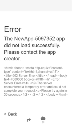

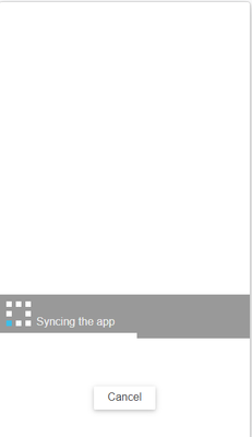

Alternatively, I tried to use a Virtual Column to calculate BoM Costs instead to get real time updates. It all works upto this point. When I replace the formula for "Cost per kg calc" with this virtual column of BoM Cost, then the app does not load. See screenshot below:
It stays on the syncing page with the progress bar loading slowly but steadily. However, after about 2-3 minutes I get this error:
I believe that it is getting stuck because BoM Cost uses ingredient costs which uses costs per kg calc which uses BoM Cost. But how do I overcome this problem and can update everything in real time?

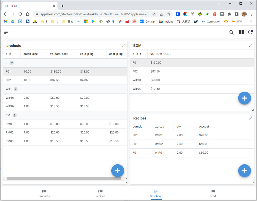

I did not have enough energy to read the whole thread...
Here is what I created.
https://www.appsheet.com/portfolio/3401559 called BOM.
The way I did is to add another table called BOM because I did ran into circular references with the original two tables also.
table recipes is a child table to BOM
Products of categories, "F (Finished Goods)" and "WIP", have an entry in BOM. recipes store non F materials and required quantities.
Though I have a bunch of non VCs defined in the spreadsheet, I have mostly done my work using VCs because of refresh timing.
You are welcome to play with it if it looks like what you are looking for..
