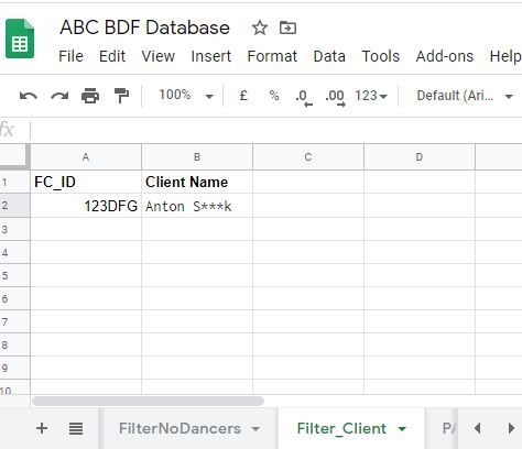

Mimicking the demo app " Slice based on user input", I have an interactive dashboard filter that should allow me to select a Client Name using table Filter-Client. That bit works ok. Then it should show on the calendar all dates that the client has (previously) attended.

where ANY(โ€ฆ) reads the Full Name of the client Iโ€™ve selected (from the FilterClient table) - the needle
