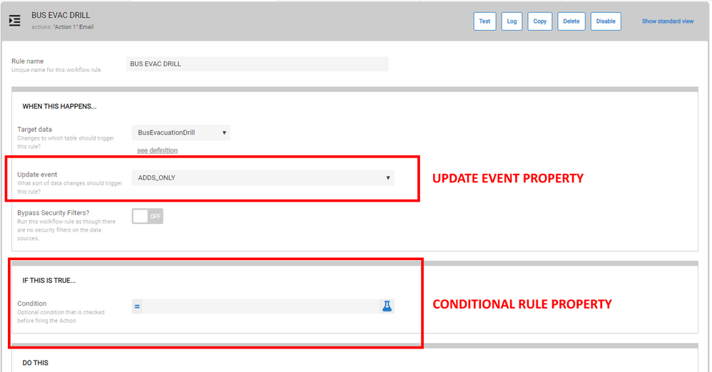

Itโ€™s possible that your workflow is triggered before AppSheet calculates the value of the AppFormula in your [Current Stock] virtual column. I donโ€™t know what kinda conditional rule you are using to trigger the workflow, but you may try with adding below expression in your conditional rule:
[_THISROW_BEFORE].[Current Stock] <> [_THISROW_AFTER].[Current Stock]
OR
NOT([_THISROW_BEFORE].[Current Stock] = [_THISROW_AFTER].[Current Stock])

@Dr_Hector_Rivera
The expression that I had provided has to be places in your conditional rule that triggers your workflow:
I donโ€™t know your app structure or how your tables might be related but you can retrieve a certain columnโ€™s value with an ANY(SELECT(โ€ฆ)) or LOOKUP(โ€ฆ) expression:
ANY(SELECT(Products[Product Description], [Product ID]=[_THISROW].[Product ID]))
OR
LOOKUP([_THISROW].[Product ID],"Products","Product ID","Product Description")

@Dr_Hector_Rivera
I notice that we are not in the same page regarding the terminology. What you are showing is the Update Event property which is set to ALL_CHANGES. No problem with that, because it denotes that your workflow will be triggered upon every action taken: adds, updates & deletes. What I was mentioning was the Conditional Rule of your workflow, which is an expression that will be checked if the rule expression evaluates to TRUE before itโ€™s triggered. Check this out:
As your [Current Stock] column is a virtual column, and possibly your workflowโ€™s conditional rule is set to TRUE rather than an evaluating expression, the workflow is triggered before the appformula in your virtual column is calculated.
The expression that I have given, shall be a conditional rule expression (or a part of it) so that AppSheet need to evaluate the value of this column and therefore calculate it.

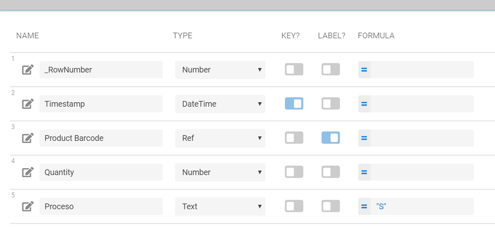

As you are triggering the workflow from a row event, you can directly refer to the column name, you donโ€™t need to explicitly use an ANY(SELECT(โ€ฆ)) or LOOKUP(โ€ฆ) expression in this case:
El <<[TimeStamp]>> se registrรณ salida del material <<[Product Description]>> <<[Product Barcode]>> por la cantidad de <<[Quantity]>> piezas quedando en stock <<[Current Stock]>>

Workflow rule โ€˜On Change in Salesโ€™ action โ€˜Action 1โ€™ Body template. Expression โ€˜[Current Stock]โ€™ is invalid due to: Unable to find column โ€˜Current Stockโ€™.
The problem is that Current Stock is the virtual variable in the table Products, differente from the Tables Sales (where I am getting all the other variables)
If I use the <<ANY(SELECT(Products[Current Stock], [Product Barcode]=[_THISROW_AFTER].[Product Barcode]))>> I get a return value different from the calculation that appears. It is even a fixed value regardless of the amount I take out of the inventory.

So your [Current Stock] virtual column is in Products table, where youโ€™re triggering the workflow from Sales table. Am I correct?
Provided my assumption is correct, do you have a REF relation between your Products and Sales tables?
Yes, the Prodcut Barcode is a Ref as seen in this image
