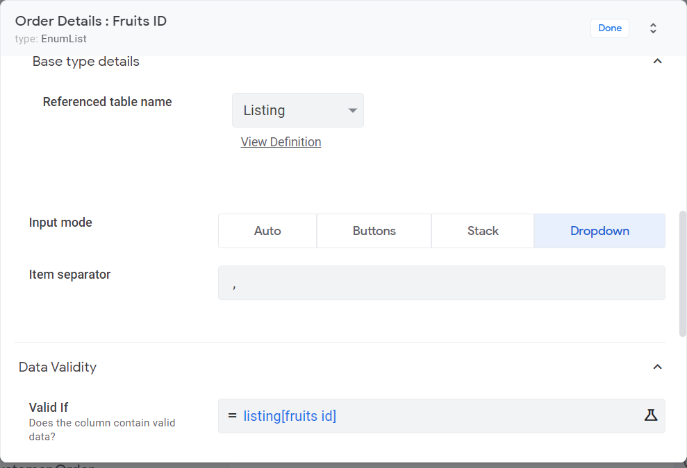

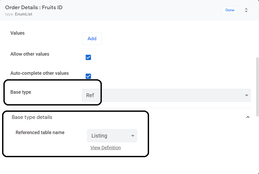

Hi Khuslid,
I know enum and enumlist hava a standard search field on top.
But i don’t know why it doesn’t appear on my app…
And below is my column setup…can you found anything wrong ?
Thank you!
Is it possible to know how many options you have under Fruits ID in the backend table? Currently, image of the drop down shows 5 options.
Hi Suvrutt !
I have 6 entires, i also dont know why the last entry doesn’t populate into the enumlist…
Thank you.
Thank you. Can you please try adding say 6 more (making total 12) and try the drop down again?

  1. Am i using the Valid_If correctly ? Refer to below photo.
  2. Do you know any sample app or links for me to understand Suggested_Values ? This is also new to me.
That’s OK as long as list values appear to be unique in the column.
You are using a REF type enumlist. Using Suggested_Values property, will add the New item to the beginning of the dropdown list which will let the user to be able to add a new fruit record. If that’s not the intention, keep the expression in Valid_if.
