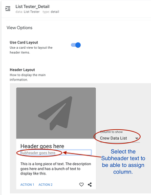

Does anyone know how and where to control these functions when using "card-layout" function? Thanks everyone! See attached photoAppsheet help.png

To assign which columns to use in the different areas of a Card View, simply select, in the Header Layout section, the text area you wish to assign a column to.  The "Column to Show" field will switch to the column used for that area.  You can then tap on the dropdown and change the column.  See the images below.
For the "second" red line at the bottom in your sample view, I am not sure if you mean to include that in your Question or if you are crossing out the name to hide it.
Changing Subheader columnChanging Subheader column
Changing Description area ciolumnChanging Description area ciolumn
