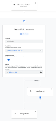

I've been working on an app feature that depends on the app detecting when information has been received from an external service. I know there are (and I have used) other techniques, but it occurred to me to experiment with Wait on a condition. When I was unsuccessful, I came across this comment.
Did @WillowMobileSys or @Marc_Dillon end up finding a way to use Wait on a condition in this scenario?
In my testing, Wait on a condition does not detect a data change made directly in the spreadsheet data source--even when the worksheet has AppSheet external eventing enabled. For example, I created an automation triggered by a row add, included a Wait condition of ISNOTBLANK([Column]), and then manually populated that column in the worksheet. The automation always routes through the Wait step's timeout branch.

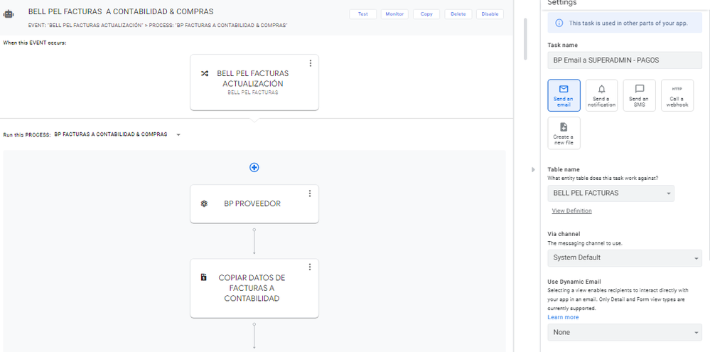

Hello @Marc_Dillon, HERE, there is an example.
Execute when there is some adds or updates, and copy to the table indicates
copy data to another table:
check if the time to date is less than 1 week
if it's true - then send an email to the admin
if not, more than 3 weeks, send an email to another person.
Thanks Sara,
If I understood correctly, you're using a 'wait for a period of time' in order to send an email out 3 weeks from the time of the initial Bot trigger?
I suppose that is indeed a case that can't super easily be solved by any other feature in Appsheet.
Well... you could insert a record into an email trigger table of sorts, with an execution date being set 3 weeks from now. Then set up another schedule-Bot that checks that table every day for actions to process.
If I had to guess, I imagine the internal Appsheet system is doing something very similar.
Although setting it up yourself gives much more visibility into it, and you can freely "cancel" the execution, by deleting the record, if necessary, or even changing it.
For a one-off case, I'd probably go with the wait step. But for something that I may be setting up a lot, I'd probably use the home-built setup that I described.
Thanks again for your real life usage!
