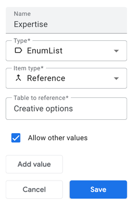

It sounds like the column structure is not exactly how you described.. like which column in the Art and Craft Options table is the key column affects.  Would you please take a printscreen from the column structure in "Teachers" and "Art and Craft options" tables.
Because I'm using the native AppSheets database both tables have an auto-generated (and hidden by default) key column called "Row ID". The Name column in Teachers is marked as the label for its table. The Options column is marked as the label for its table.
This is how the "Teachers" table references Options as an EnumList:
 I've simplified a few of the names for this post but I have been rigorous in the consistency of translation, i.e. the problem isn't mistaking a table for a column or whatever. This is what Options/Creative options looks like in AppSheet:
[Personnel] is what I've been calling [Teachers] etc etc
