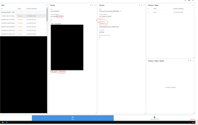

The Event fires, correctly but it stays on PENDING forever:
0 4 275

I am also getting this error. I have "000:05:00" to delay my sequence flow by 5 minutes before moving on to the next step and it is stuck in pending forever as well. Please let me know if you have found a solution to get around this.
The Solution was, to contact Google. The fixed it for me:
Hi Philipp,
Thanks for your time and patience, it is really appreciated.
This is to inform you that we enabled the cloud scheduler for the EU region. Please let me know if the wait step is still having issues. We will be glad to help you.
Best Regards,
AppSheet support team
