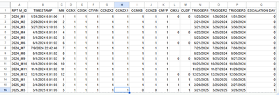

I am trying to find where is my mistake that the value of [TRACKER] should be change from 0 to 1 and if the value is 1 it will remain as 1. Example [PROJECT SITE NAME] CCNX subjected the form from the PROJECT LIST table the value of [TRACKER] will update from 0 to 1 or remain as 1 if its at 1 state. Why site CUSF and CMXJ cannot update to 1? I can't anything wrong with my expression
SWITCH(
[PROJECT SITE NAME],
"CCNX",
IF(
AND(
COUNT(SELECT(Submission[CCNX], [CCNX] = 1)) = COUNT(Submission[CCNX]),
[TRACKER] = 0
1,
[TRACKER]

The concept is as follows:
If this happens, then that happens, otherwise this other thing. (this other thing) is another if, that is, it's a nested "if."
If any of the initial conditions are met, then it's 1; otherwise, it analyzes another situation; this is where status = active comes in; if so, then 1, otherwise, take the value from the tracker column.

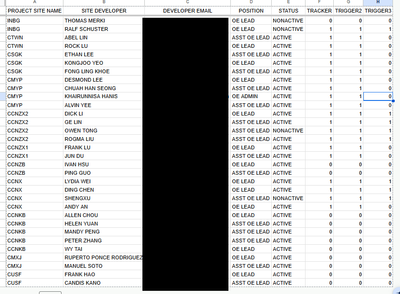

Wow !!!! you are amazing. The test answer is correct where CCNZB has no submission and it's o. Beside the [TRACKER] there is a column [STATUS]. What if say I only want [STATUS]="ACTIVE" and make [TRACKER]="INACTIVE]" permanent [TRACKER]=I

Hi Gustavo
The first item is not correct. BTW what is "I" for in this -([TRACKER] = "NONACTIVE", "I"

Sorry for the delay in the answer. You have written โ€œIโ€, that's why I thought I was a value you needed.
hahaha sorry. So if the column [STATUS] has two value as follows [STATUS]="ACTIVE" AND [STATUS]="NONACTIVE". IF the value is then the [TRACKER]=1 permanent. The rest is the same
Ok, then try this:
IF(

The first row with [STATUS]="NONATIVE" still return 0. So I tweak a bit in the below and got it
IF(
[STATUS] = "NONACTIVE",
1,
IF(

Submission[RPT M_ID], ISNOTBLANK([CCNZX1])))),
AND(
[PROJECT SITE NAME] = "CCNKB",
COUNT(SELECT(Submission[RPT M_ID], [CCNKB] = 1)) = COUNT(SELECT(
Submission[RPT M_ID], ISNOTBLANK([CCNKB])))),
AND(
[PROJECT SITE NAME] = "CCNZB",
COUNT(SELECT(Submission[RPT M_ID], [CCNZB] = 1)) = COUNT(SELECT(
Submission[RPT M_ID], ISNOTBLANK([CCNZB])))),
AND(
[PROJECT SITE NAME] = "CMYP",
COUNT(SELECT(Submission[RPT M_ID], [CMYP] = 1)) = COUNT(SELECT(
Submission[RPT M_ID], ISNOTBLANK([CMYP])))),
AND(
[PROJECT SITE NAME] = "CMXJ",
COUNT(SELECT(Submission[RPT M_ID], [CMXJ] = 1)) = COUNT(SELECT(
Submission[RPT M_ID], ISNOTBLANK([CMXJ])))),
AND(
[PROJECT SITE NAME] = "CUSF",
COUNT(SELECT(Submission[RPT M_ID], [CUSF] = 1)) = COUNT(SELECT(
Submission[RPT M_ID], ISNOTBLANK([CUSF]))))
1,
[TRACKER]
I have another question on this same form but instead of submission form it on another table. The action is still on [TRACKER] column. Post on the title - Return Table OE Lead V1 to 0 if it's 1
I think your formula might be a bit inefficient. Please try something like this.
IF(
  1,
  IF(
    OR(
      AND([PROJECT SITE NAME] = "CCNX", [MatchingCount] = [NonBlankCount]),
      AND([PROJECT SITE NAME] = "CSGK", [MatchingCount] = [NonBlankCount]),
      AND([PROJECT SITE NAME] = "CTWN", [MatchingCount] = [NonBlankCount]),
      AND([PROJECT SITE NAME] = "CCNZX2", [MatchingCount] = [NonBlankCount]),
      AND([PROJECT SITE NAME] = "CCNZX1", [MatchingCount] = [NonBlankCount]),
      AND([PROJECT SITE NAME] = "CCNKB", [MatchingCount] = [NonBlankCount]),
      AND([PROJECT SITE NAME] = "CCNZB", [MatchingCount] = [NonBlankCount]),
      AND([PROJECT SITE NAME] = "CMYP", [MatchingCount] = [NonBlankCount]),
      AND([PROJECT SITE NAME] = "CMXJ", [MatchingCount] = [NonBlankCount]),
      AND([PROJECT SITE NAME] = "CUSF", [MatchingCount] = [NonBlankCount])
    1,
    [TRACKER]
There is an error. Macthingcount - I never seen this function before. Submission table has only value 0 an 1. There is no other value
Okay, maybe it's my mistake. I haven't tried it, that's the truth. The thing is, I see a lot of selects together, so it seems to me that an alternative could be made.
Thank you very much. You are awesome. There is another question in a separate post and still on this form and this very same table table. Just that the submission table will become survey Matrix table
Thank you so much for your kind words. Send me the link to that post. If I can help, I'd be happy to.
