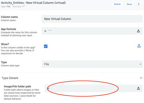

Is the Virtual Column defined as type of File and is there anything implemented in the File Folder path property?  See image below.
Edited:  As I think about this more, the problem is the location of the datasource.  There is a long standing problem, a significant flaw in my opinion, where AppSheet uses the default app path to write the file.  But when it comes to retrieving the file, AppSheet uses the location of the datasource as the "root" location.  Why the App default path is not used always, I don't know.
I believe you will need to use the URL type and provide the full file path info to get at the file.

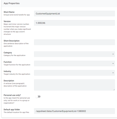

Docs made through bots are saved on the Default App Folder found under Info/Properties/App Properties
Docs uploaded on image or file column is saved relative to the GSheets/MSExcel file.
When you make docs through bots and you want to access them the same you do with files uploaded, you have to make a path to the file standing from the worksheet's pov.
