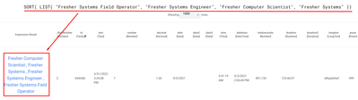

Unless AppSheetโ€™s SORT() is doing something out of the ordinary, I believe one has to take spaces into account because SORT() wouldnโ€™t know about words. Therefore, it would be necessary to remove them before sorting or resort to sorting a list of lists.
Iโ€™m not able to test right now, but if Iโ€™m correct, โ€œFresh Sys Techโ€ would go before โ€œFresh System Devโ€.
Confirmed.
So we should use orderby and substitute the spaces then
Yes. I initially thought of using SPLIT() on the list elements, but I've discovered that AppSheet's SORT() doesn't support sorting a list of lists !!!! So I think your suggestion is the only option I can quickly think of.
