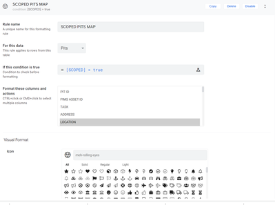

I have format rules in place that are working fine to color pins on a map. I am trying to do another format rule which is exactly the same but just reads from a different column and this one won't work for me.
I have it at the top of the rules list, and I have just copied another rule and changed the formula to include the new source column.
The circled pins on the map shown should be pink..
I can't figure out what I'm doing wrong

Thanks so much for the quick reply dbaum!
I have the SCOPED set for Yes/No, but still not working.
Do you have any other suggestions?

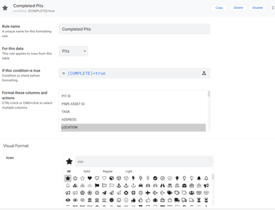

It is exactly the same as [complete] which works fine???

AHA!
I had it at the top of the list. I put it down the bottom (last) and that fixed it.
Thank you so much mate!
