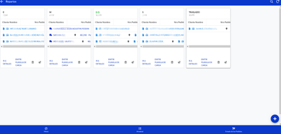

Cards dissappeared from Card View, in a PC monitor
Users of an app are not seeing all the cards displayed at the Card View. As of today.
Nothing changed within the app. Just seems to show less but wider cards as if the screen was wider than it actually is.

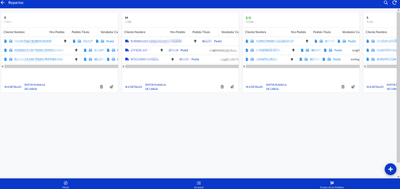

View Before: (it is a computer that somehow is displaying the "old" way)
New view, is showing wider cards but less cards per page and there is no horizontal scroll
In fact if the user increases the zoom of the navigator, the view is populated again with all the cards but unfortunately it is not usable.
Happens in Chrome and Firefox. No problem seen in a phone or tablet.
