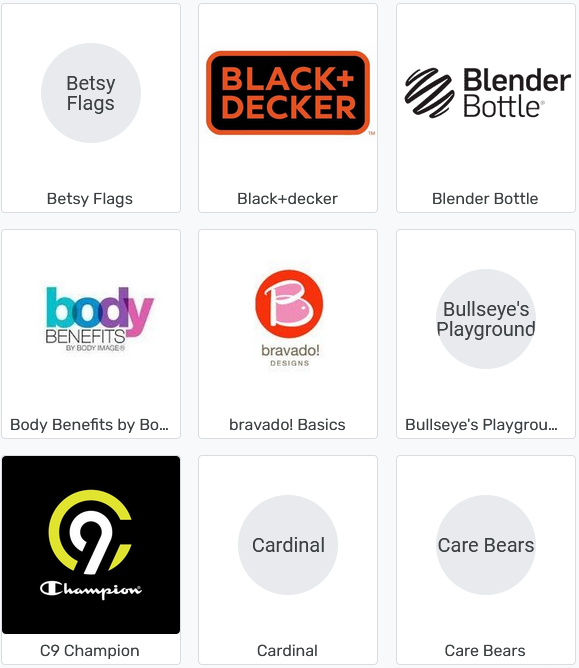

Hi everybody,

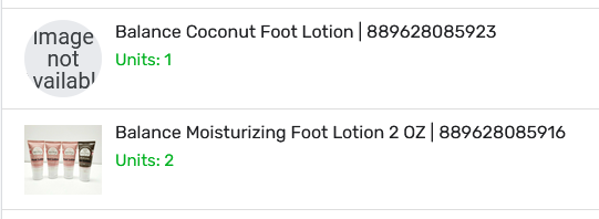

I was wondering if itโ€™s possible to change the thumbnail to square shape when I use the TEXT_ICON FUNCTIONโ€ฆ
To be more specific. I have a list of products with square thumbnails already and for those products that donโ€™t have an image in their records I show the function so it doesnโ€™t look like a white space.
I have also done this with other tables such as brands and customers so I wouldnโ€™t like to upload the same not available pic everytime.
I thank for any help in advance.
Regards.

Thank you for your answer, changing the field to image seems to give me full control of the shape but Iโ€™m still concerned that once I have several records, the sync time might be affected.
The only reason I was using this format is because I read that thumbnails are lighter formats, and I thought I was going to have the same shape control as image.
