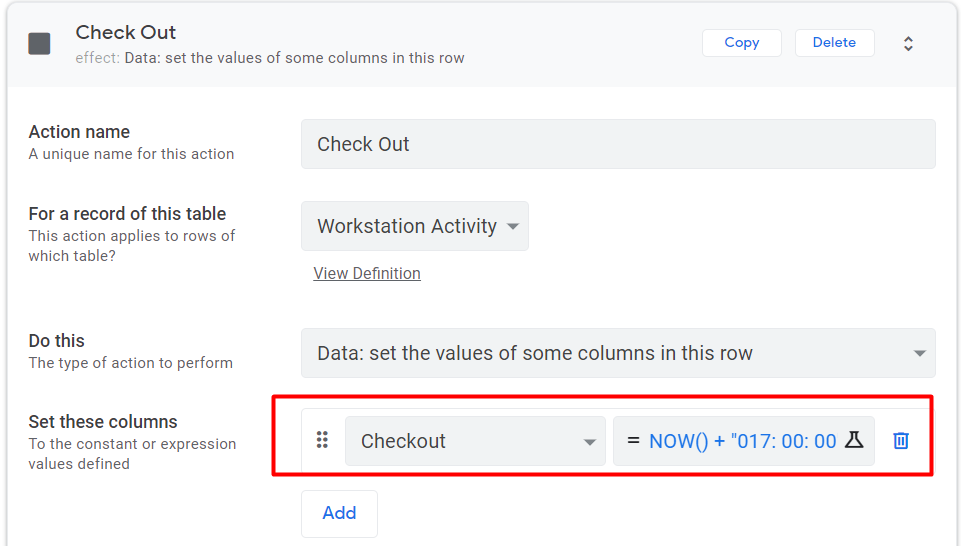

Iโ€™m trying to develop an application. The person who comes to the company will check-in and enter and these entries are written in the table. No problem. They just forget to checkout. How can I write the 17:00 checkout rule after each checkin.

In fact, to summarize, I want to make a table reservation. People who make check in write sheets and I want to print there as 17:00 in the check out column. So everybody should reserve their table, but when it is 17:00, all tables should be idle.

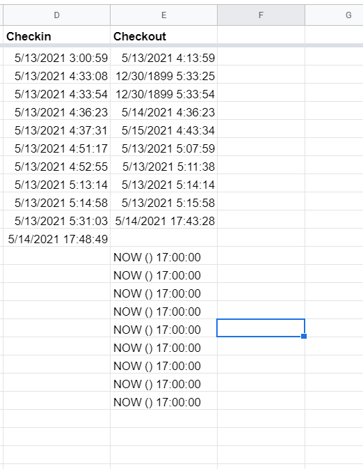

When I type NOW () + โ€œ017: 00: 00โ€ here, it just shows my check out time as 17:00. Please help with this

After all check-in is done, I want to print 17:00 in the column even if the person doesnโ€™t checkout. Checkout must be at 17:00 after each checkout

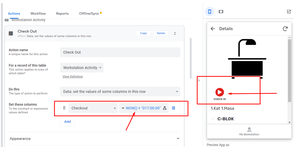

When you type this parameter, the check in button does not work.

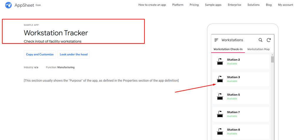

I am using the application in the appendix as an application, you can see it from there. My goal here is that the incoming person forgets to checkout after checkin. After each checkout, the same day at 17:00 should be able to checkout by the system. but how?
Youโ€™ll need to setup a Bot, with an โ€œscheduleโ€ driven Event, to run at 17:00 every day, that will run a Process on every record that has not been checked out.
