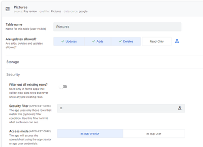

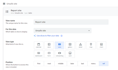

Child table not showing in parent table form

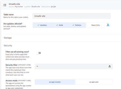

I need help understanding why my child table Pictures don't show in the form for my parent table Unsafe site.

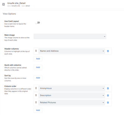

The child table does show in the details view for the parent table, so don't think there is a setting issue.
Screenshots that may answer some questions you might have for me. to help narrow down the issue.

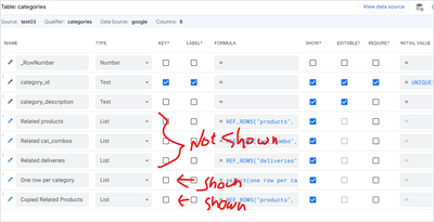

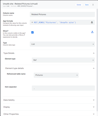

It seems system generated "Related xxxxs" fields are not displayed in a Form.
You could try to create a VC manually with the same App Formula.
@TeeSee1 Thanks for your reply.
I created a manual VC, but it doesn't show either.
Hmm interesting.
Here is what I get

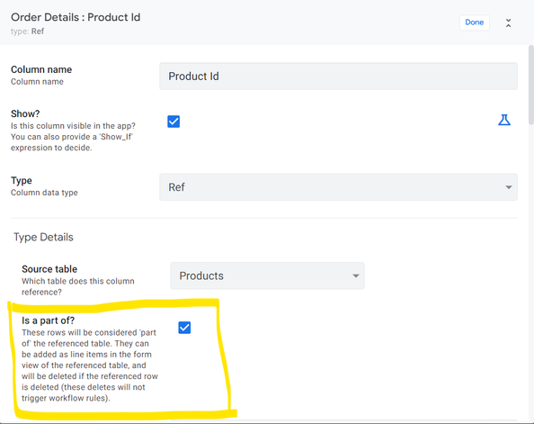

If I set "is a part of", then the column DOES show up as @Suvrutt_Gurjar suggested.
Since it is not always correct to set it (depends on your use case and your case seems to fit this one), you can keep the workaround in your tool box. (It seems you are having issues with both of them...)

You may want to mark the reference column in the child table as "ISPartof" for the related records from the child table to appear in the parent form. But please do read the  restriction that is associated when you select the "Is a Part of" setting.
The restriction is when a parent record is deleted the "IsPartof" child records are also deleted when you enable this setting.

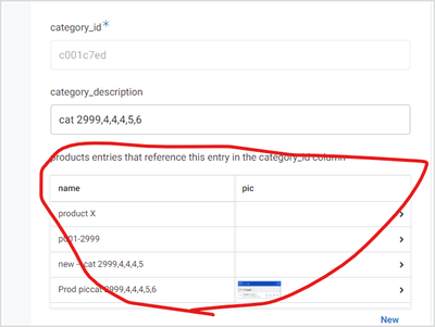

The sample setting shown below

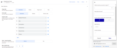

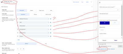

@Suvrutt_Gurjar" Is a part of?" made it appear at first. But it's not working again after I tried to delete the duplicate VC suggested above.
Any idea what I can have done to make it disappear again?
Please check your configuration again. Is the system generated [Related ....] column present in the parent table as well as parent form's column order?
@Suvrutt_Gurjar Everything is the same as before, as far as I can see 😕
