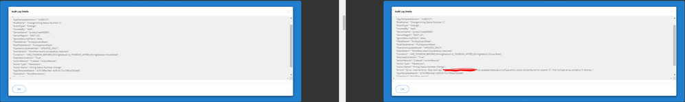

I am having the same issue.  In my case, I am using Big Query and added a sheet-based table set as the child table to a pre-existing database table.
The automation throwing the error is calling a Google script and then attempting to update the Parent row that has a "Related" column - the column complained in the error.
What is extremely odd is that this automation has 2 steps of very similar steps to make 2 updates on the same row.  One succeeds just fine.  The second fails with the error.
Any hints on how to address before I spend hours on it??

Exactly what I have discovered.  The app seemed to magically fix itself earlier this week.  Today, I tested the automation by adding an additional step.  When it didn't work and I deleted that step, I again get the error message noted above.
It took 3 days for the app to "heal itself" before.  I can't wait that long.  If I have to, I'll remove the automation and add it back in again and hope that resolves it.
I will open a ticket to Support.  Did you happen to open a ticket previously?
EDITED:  FYI! I tried duplicating the automation as well as creating anew.  The issue still occurs.
EDITED 2:  One thing I didn't articulate above, is that when I started getting the message the second time, the failure happened on the first "SAVE" Step of the automation - not the second "SAVE" step like before.   I switched back to the original automation (which was just simply disabled) and the error again happens only on the second "SAVE" step.  So it would seem when the error occurs, it is specific to the automation.
