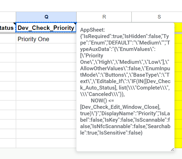

Hello again. Since I have to repeat many columns with complex configuration, I found this that can help me.
It consists of inserting the configuration of each column in annotations of its header. I have seen it on Multitech Video, on YouTube.
Does anyone know how to extract this information from an existing appsheet column to duplicate it in G sheets?
You might find this useful - https://www.googlecloudcommunity.com/gc/AppSheet-Q-A/Appsheet-pulls-Notes-from-Google-Sheets-header/... though I have to admit I do not have first hand experience. From the reading of it, this is an obscure feature.
Rereading your last post
it seems you may have to build it manually?
