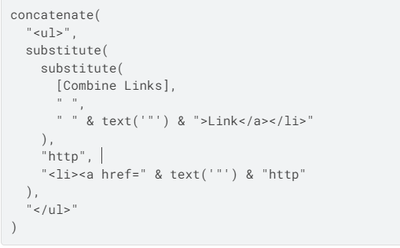

Interesting, I just performed a test and it worked fine, I imagine there must actually be some hidden character (like newline or similar) in the [File Upload] column which is preventing the substitution. Try the following which should work regardless:
concatenate(
  "<ul>",
  substitute(
    substitute(
      [File Upload],
      "pdf",
      "pdf" & text('"') & ">Link</a></li>"
    "http",
    "<li><a href=" & text('"') & "http"
  "</ul>"
I appreciate your time and help so much. It is still printing the code.
OK this definitely works, I already had some rich text (generating a table) in one of my apps so I just added this code onto the bottom of my expression and got this:
