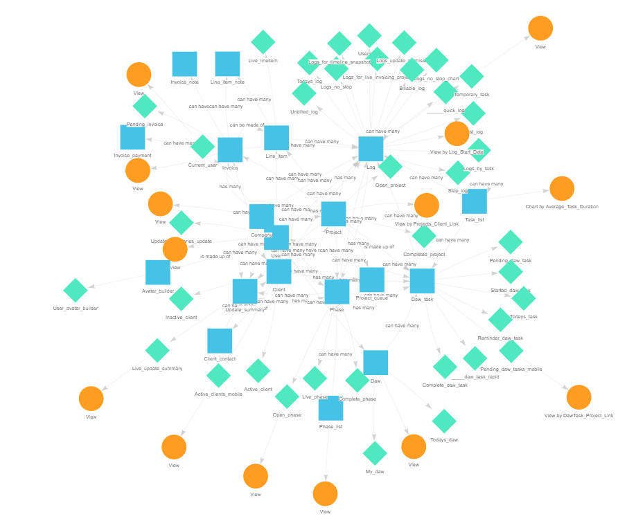

If I detail out the hierarchy of my main time-tracking app I use for tracking the progress of my projects, it looks like this:
  • Clients
    • Projects
      • Phases
        • Logs
      • Notes
  • Invoices
    • Invoice_Notes
    • Line_Items
      • Line_Item_Notes
    • Invoice_Payments
  • Users
Plus a bunch of supporting tables to hold various lists.
When you get this complex what are on average app sync times?
I count something like 18 or 19 seconds.
I should note: this has two years worth of data in it (Iโ€™ve yet to go through and clear things out from last yearโ€ฆ #LazyAss).
This app is also a dinosaur - the need for a rebuild has been ever-increasing. It was built 2 years ago, and there are a lot of workarounds built in that are now actual features of the platform.
So this is kinda worse case scenario here.
Helpful Tip: The animated circle thing takes about 1 second to get from one corner to the other - thatโ€™s what I was pointing out with the pointer.
