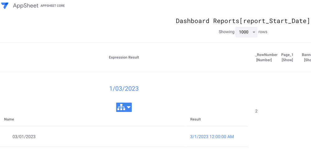

Thank you. Could you update if the expression Dashboard Reports[report_Start_Date] returns a single value and if [report_Start_Date] is a date or datetime column?
[report_Start_Date] is a Date column type. Dashboard Reports[report_Start_Date] returns this 3/1/2023 12:00:00 AM Thanks for the help so far. Sorry on further checking the Dashboard Reports[report_Start_Date] returns 1/03/2023 for the Expression Result, however when you expand the output of the result to show the calculation you get the attached visual output.Screenshot 2023-03-19 at 4.35.03 am.png

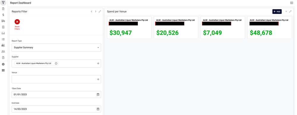

Hi Suvrutt, I have tried the expression & there is still no clear filtering of the related invoices. I have attached a screenshot to show you the output. No matter the date ranges selected, the output is all invoices for the supplier. Nothing filtered by the date ranges. I am using a "Report" table for the filter constraints. The Parent table Suppliers has related invoices, the child records. The invoice table is joined to the Supplier via a Ref field [link_Invoices_Supplier]. This is not a part of the referenced Supplier table. All the references seem to be intact & working as expected in all other facets of the app. I am not sure if there is a guide to get filtering date lists, but this is consuming all my brain power & a smidgen of yours! I am really sorry & appreciate your help immenslySpend PEr Venue 1Jan to 14March.pngSpend Per Venue 1March to 14March.png
 Thank you for the details. However the screenshots do not help much as on the right hand side there are no dates in the card view, so not able to understand the details. Also I am unable to understand what tables the view is based on on the right hand side. Left hand side of course seems to be filtering arrangement. At this point it will be good to know a snapshot of the relevant tables, and all column types and views used in the expression to proceed, During each post also the latest expression used will help.
Also you seem to be using new desktop UI. I would be personally apprehensive about using new desktop UI at this stage on a production app or extensive calculations because it is still in preview mode.
Hi Suvrutt, thanks again for helping me here. I will revert the app to the legacy desktop & check the filter behaviour. For your other information: The view is a Dashboard view "Reports Dashboard" based on a "Reports Filter" view & a "Filtered Supplier Summary"  view. The tables of the views are: "Reports Filter" is based on the slice called "Dashboard Reports" from the "Reports" table. This table has dedicated columns for the various report filters & output files - Column types are "Date" for the Start & End Dates, Enum List for the Supplier & Venue filter columns, Text for the Invoice number filter. The Supplier table has the standard ref columns to the Invoice table. I have attached screenshots of the tables & vSupplier TableSupplier TableSupplier Table contSupplier Table contSupplier Table cont2Supplier Table cont2InvoicesInvoicesInvoices contInvoices contInvoices cont2Invoices cont2Report Filter  ViewReport Filter ViewSupplier Summary View (for the invoice totals)Supplier Summary View (for the invoice totals)iews for your reference.
