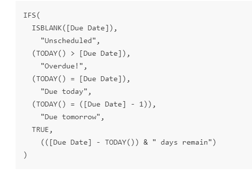

IFS(), not IF().
Does not work. Would you have any examples to show me? I did the expression using IFS but it didnโ€™t solve my problem
Please post a screenshot of the expression you tried.
Read the posted help article.

Good. Now re-incorporate the AND() expressions similar to how you had originally done. Remember you just have 3 conditions to check against, so you should only have 3 condition-value pairs in the IFS().
The doc posted above has several examples. Perhaps you should look at it.
You have 3 cases as shown above. Youโ€™ll have to check the last case first as it can override the logic for the other 2.
