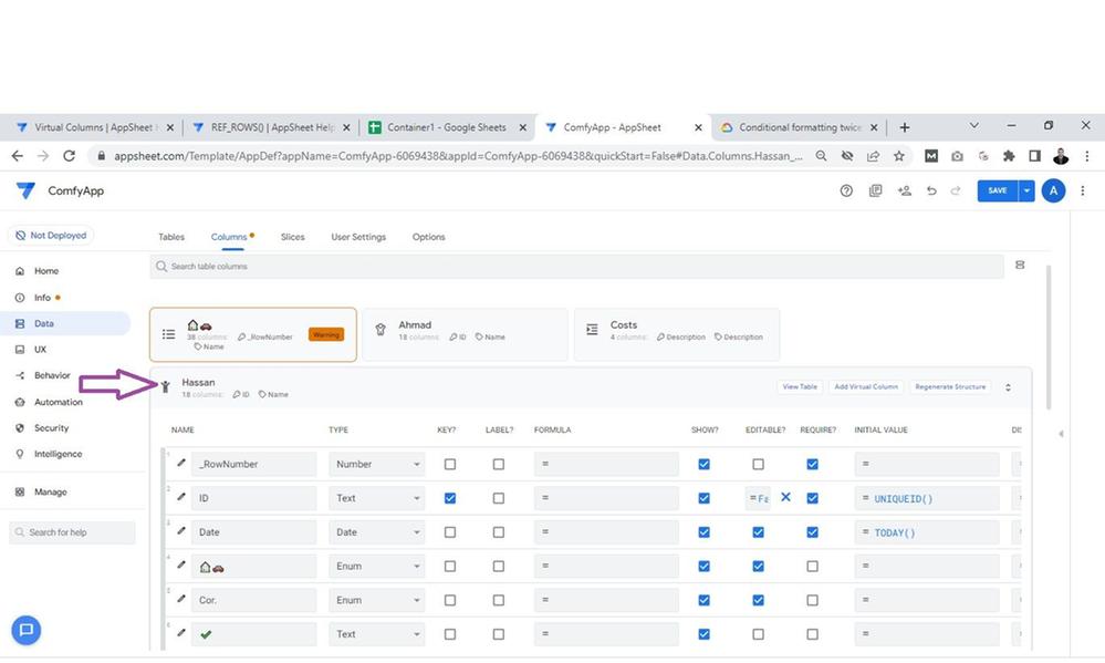

1 >> I want to create the virtual column in (Hassan Table). see image below.

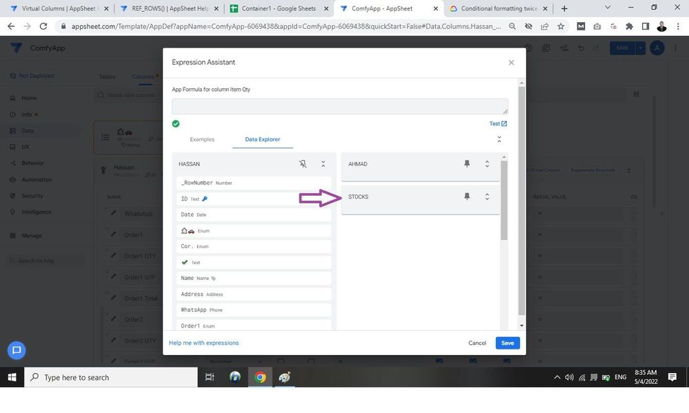

2 >> The virtual column should fetch data as it is from the table called (Stocks) and column called (Item Qty). See below image.
3>> Here is the virtual column name I made. see Image below kindly.
4>> In the virtual column formula part I just inserted the (Item Qty) from (Stocks) table. See the three images below please:

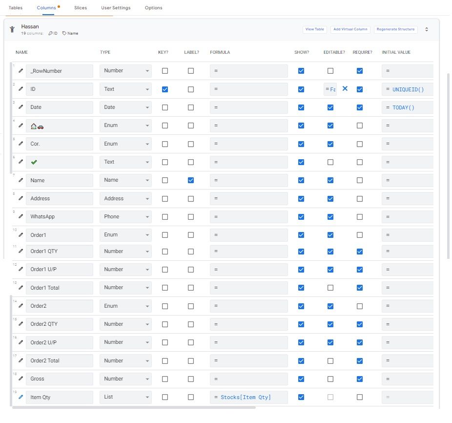

5 >> Then I saved and here is the virtual column shown in (Hassan) table. See Image below:

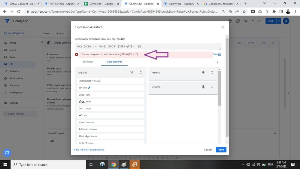

6 >> Here I went to (Hassan) table and wanted to create a conditional formatting formula.  Like what you have suggested.
AND([ORDER1] = "BASIC CHAIR",[ITEM QTY] < 10)
But I got below error
7>> I then went to the virtual column and changed from List to Number. still I got error below.

Definitely not bothering me! The way you have laid it out is a great start. Tackling the issues/solutions one-by-one is really the trick to learning effectively.
I will try and go through these one by one, piece by piece and steer you in the right direction. it might be slow, but we will get there.
First question, is your virtual column returning the correct value? It looks to me that it wouldn't be returning the correct value at all.
You will need a piece of data to tie to the Hassan and Stock tables together. Are there two columns that share the same input? (ie. Item Name, Item Code, etc?)
Or to ask in a more simple way, where would "BASIC CHAIR" be selected in the HASSAN table?
When you use a SELECT() function, it will return a LIST value, regardless. There are tips around this, but we will get to retrieving the correct value first.
