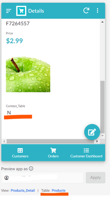

if I use CONTEXT("Table")= "Table 1"  in  Y/N type column a view based on Table 2, it returns FALSE or N.
In the example, below, my expression for the [Context_Table] column is CONTEXT("Table")="Orders" and the column is in view based on "Products" table. It returns FALSE as expected.
The column definition in the "Products" table

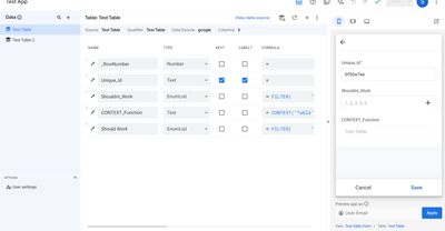

I've set the columns up to show all the different cases at the same time to reduce the need to change the formula's back and forth.

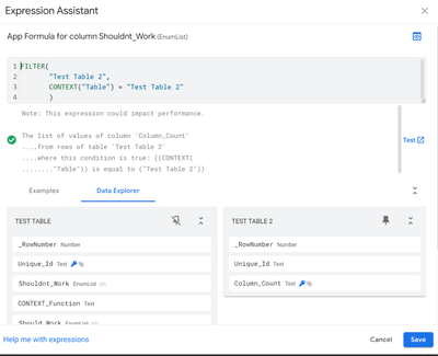

Here we have "Test Table" where we set up three Columns:
Column "Shouldnt_Work":
Notice that it's called "Shouldnt_work" because that Table context is not the table of the column, instead it's a different table "Test Table 2"

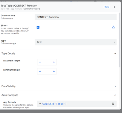

Column "CONTEXT_Function"
Directly reference the function from a field as a baseline:

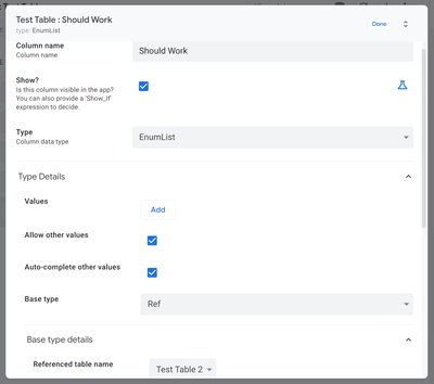

Column "Should Work"
Same as the "Shouldnt_Work" column but this time the CONTEXT() function matches the correct "Table".
MONEY SHOT
Going to add a record on the "Test Table" shows that despite being on the "Test Table" table and view, the FILTER() functions read of a different table has highjacked the CONTEXT results and it's now localized to that table. "Should Work" just doesn't show up because it doesn't return any results.
FYI: "Test Table 2". Which has been set up to have 5 entries of 1,2,3,4,5
Additional ramble: I can guess (appsheet is new to me) at how this happened. The process appears to be pointer based, so the code thinks it's on the "Test Table 2" because the conditions in the filter are localized, or index reads, from the table in the first parameter of the function, i.e. you can reference column, e.g. [whatever] directly without a table specifier in the second parameter of the function, instead of what you'd do in an object orientated based language of specifying the full object.property. But that being said, the function CONTEXT() should not be influenced by the formula's function reads and you can't chuck a [_THISROW]. on the CONTEXT() function (I think) and nor would I if I tie it back to the Security Filter scenario causing me the grief.

Test a column  in Products Table (Table 2)  based view by getting records from the Orders table (Table 1)  by using CONTEXT( "Table") = "Orders"
So my expression for the [Context_Table] column is
FILTER("Orders", CONTEXT("Table")="Orders")
The result when tested in a detail view of Products table ( Table 2) is surprisingly unexpected, at least as per the description of CONTEXT('Table") in the help article "
  • Table - Name of the table used by the current view."
Or our( my) interpretation of this description is incorrect. But the results are in line with your testing and finding.
As the image shows, all the keys of the "Orders" Table ( Table 1) are returned in the view based on Products table(Table 2).
