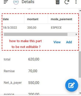

Hi .. I have fildes which I want to no longer be editable , when I mark "Complete" in [Status] column
know that I use Editable_If expression as solution but for columns which contain "REF_ROWS" formula it does not work with
any suggestions please how to control whether these fileds to be editable or not

Thank you  Srikanth_S . I want to control related avance column in form to NOTbe edited
I try some formulas but I think maybe I don't know how to make it  :
I go on Only if this condition is true ..as you said I type :
[invoice].[Status] # "Complet"     error message 😞
LOOKUP([_THISROW].[id_avance],“invoice”,“id_invoice”,“status”) #“complet  Add button disappear completely 😞
Can you help me to set a right formula please .. thank you
I was not sure exactly what you were looking for.  I made a few assumptions like below.
1) On the Detail view of those Invoice rows with status "complet",  you do not want to show the add button for avance.
  • Set the system generated Add to "Do not display" <- This Add action, which is attached to the table avance, cannot be controlled based on the values of individual avance rows because it is NOT a row-level action.
  • Create a Add Avance action (name it as you like) for Invoice using "Data: add a new row to another table by using values from this row", You can prepopulate [invoice_id] and others as you like (you can use Initial Value also). Then in "Only if this condition is true" of this action, set [status] = "No", meaning you can add avance rows only if the [status] of the Invoice row is "No".
2) You do not want those avance rows whose parent Invoice row's [status] is set to "complet" to be edited.
  • You set the "Only if this condition is true" of the system generated Edit action of avance to [invoice_id].[status] = "No" (could be [invoice_id].[status] <> "complet" ..)
Hope this works for you.
