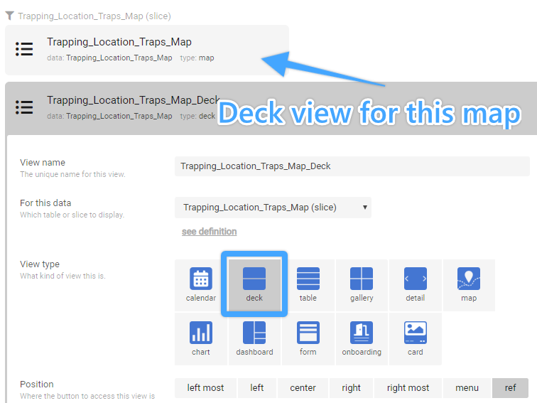

Create a Deck View using the same datasource (table or slice) that is being used in the Map. The Map View should automatically pick up that Deck View and use it.
Perfect solution John - Iโ€™m very grateful to you. Have a wonderful Sunday.

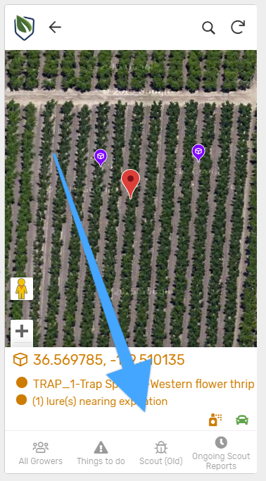

If you configure a deck view for the same table that has a map view, when viewing the map the view underneath a map DOES use the deck that you specify:
However it does not use the event action you selected.
This would greatly help smooth things out and reduce some duplication of views Iโ€™ll have to create in order to keep the detail view uniform.
In the app Iโ€™m working on, Iโ€™ve created a slice that Iโ€™m using for inline views when I wish to see the map; but since I canโ€™t use the deck selection event action (to route someone to the regular detail view) in order for the detail views to be uniform, I have to create duplicate detail views.

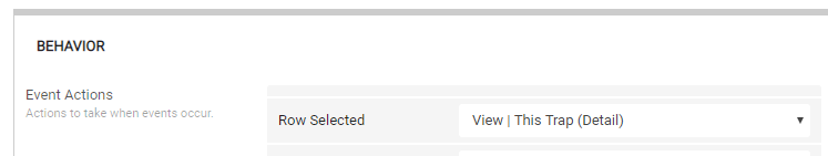

Yes the Event Action is not working. I mean you can specify an Action as a Row Selected Event Action. But it will not be fired. It will always open the Detail View. But I want to use a Data Change Action instead.
