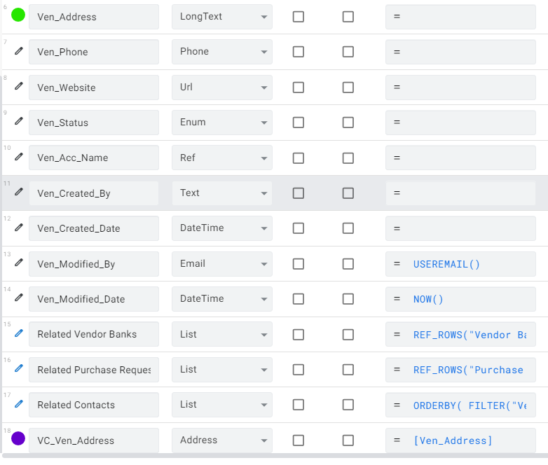

i have a table named [Vendor]. It has column named [Ven_Address] as LongText.
Can I display it as Address using Virtual Column?
I tried to create a new Virtual Column named [VC_Ven_Address] as Address, with Expression : [Ven_Address]

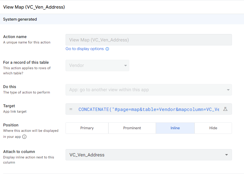

my Action Button (View Address) wont show even if i have set the [VC_Ven_Address] type as Address, with the right expression.

Please ensure you have included the [VC_Ven_Address]  as "column to attached to " and set it as an inline position in the system action created by the app.
I did, Yet still not showing.
The real Address Field is [Ven_Address] which is a LongText data type, since I need it to be long and multi line address so we can use it later in Documents and Mailings.
While the virtual is [VC_Ven_Address] which is an Address data type for enabling it to be viewed in map. Below is the column details.
