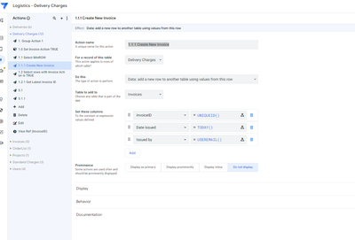

I want to create a work flow as follows.
STEP 1 - select Multiple lines in table A (Charges)
STEP 2 - Click a button called 'Create Invoice' in (Table A)
STEP 3 - this creates a new single row in Table B (Invoices)
STEP 4 - Copy this latest InvoiceID from Table B to selected Multiple rows in the Table A Charges
I am failing at, when i select multiple rows in Table A (charges), it is creating multiple rows in Table B (invoices)

I attempted the Option B as follows
1.0 Set Invoice Action TRUE
1.1 Select MinROW
1.1.1 Create New Invoice
1.2 Select rows with Invoice Action is TRUE
1.2.1 Get Latest Invoice ID

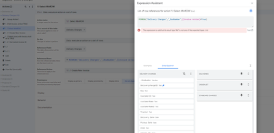

Error in selecting the MINROW
not able to move past this
What am i doing wrong?
thanks
See how it says 'List' here:
That's the data type that is expected/required. MINROW() only returns a single value. Just wrap it in LIST().

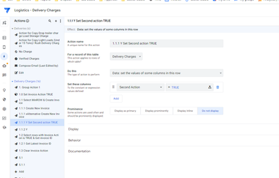

I tried adding one more step, SECOND ACTION Column marking the MINROW of INVOICE ACTION Column TRUE.
execute only for SECOND Action = TRUE to create Invoice
It was successful in marking only one row in the same table as TRUE
But i get the same error incase of another table.
Multiple invoice created for multiple selections
