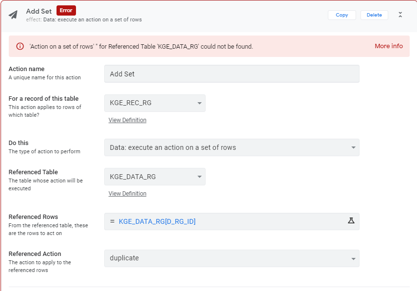

Hi there,
i am trying to add a set of data to a Table. So i tried the duplicate + execute an action on a set of rows.
But i am getting the error โ€˜Action on a set of rowsโ€™ โ€˜โ€™ for Referenced Table โ€˜KGE_DATA_RGโ€™ could not be found.
Thatโ€™s very odd. I encourage you to engage Support for help with this one. That looks like a bug to me.
Try selecting something different here:
Then re-select the โ€œduplicateโ€ Action that you want.
Good call.
@Marc_Dillon Thx. That did the trick. I even tried to delete and redo the action it didnt work, but saving it with another function and then change to duplicate worked.
Seems strange.
