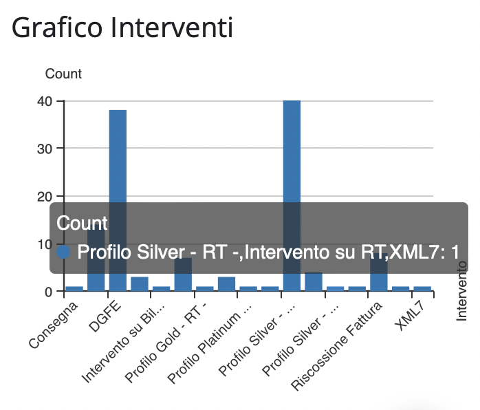

I did and it count the rows in a EnumList column. The problem is that when I select, for example, two occurrences in the EnumList, the chart doesnโ€™t count 1 of the first and 1 of the second occurrence but create a third data which is โ€œFirst occurrence, Second occurrenceโ€

As u can see the column of the chart I selected refers to โ€œProfilo Silver - RT -, Intervento su RT, XML7โ€, but I want it to count as one โ€œProfilo Silver - RT -โ€, one โ€œIntervento su RTโ€ and one โ€œXML7โ€. In fact you can see that those occurrences already are under the chart

Each column of the chart should represent the time a kind of Technical Intervention is done. Every time a technician do a Technical Intervention fill a form. All the values are saves in a Google Sheet in a column called โ€œInterventionโ€. If the Interventions put in the form are more then one there is this problem
