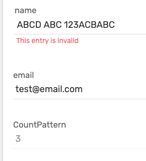

So in my sample app ^, I set up a column as an EnumList - just for easy adding/editing the list.
Another column that uses the list for valid if values to select a pattern, so that you can only count full items in the list - so no partial or fuzzy counting.
A VC to reformat that list into a Text string to work with.
And another VC with a slight change but otherwise the same formula originally posted by @GreenFlux, targeting the VC with the reformatted list.
Works for 1st item, last item, pen vs pencil, several sequential of the pattern, mixes of spaces, and anything else I could think of.
Bahbus
It doesn’t have to be an underscore, per se. But in order for extract to pull a mention correctly, each “item” in the list can’t have spaces in it. So you could just remove it a different way like SUB([List], [Pattern], “@howdoyoudogoodsir”) and skip my more complicated sub. But you know, ideas.

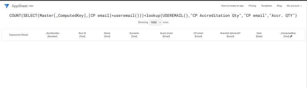

The fact is that I tried and tried again and again, but it's still not working.
1. I applied the formula to the ADD action button, so that once the limit is reached and the formula is not true, the button disappear and the user cannot add new guests
2. I checked that the "Granted quantity" is a Number field type (so that is comparable with the count made by the formula)
3. I changed it to only < (instead of <=), because if the limit is 2, and there are already two records, I want the formula to already be not true
4. when I click on "Test" near to the formula, it returns  me this (empty screen):
Is there a way to debug the formula, and understand what is the value returned by each of the two steps (count and lookup)?
Thanks a lot,
Daniele
You can easily check them both if you add two virtual columns and you use COUNT(..) or LOOKUP(..). Then you can find out what those two numbers are.
