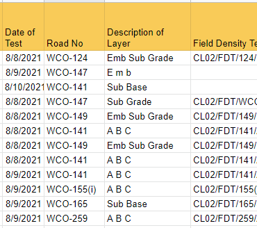

I have a problem. can you help me.
Above is part of my table. I want to select “road No” and “description of Layer” from a dropdown list of a form (Like a filter) and count how many "description of Layer"s are selected for that “road No”. How to do it?
