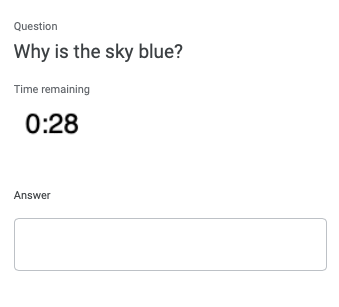

. . . I put the gif I made directly on my server and the accessed it via an img src=tag in a virtual column of the LongText type.  This has two advantages:
1. The placement inside HTML in a LongText column makes it possible to make the gif quite small.  In an image column (which was the only choice before we were give access to HTML), it would be pretty big.  Now the countdown clock looks like this:
2. The second advantage is that with the "normal" gif address (before HTML became accessible, only a special way of accessing gifs on Google Drive would work), I can append text as follows:
The text I have appended following a question mark is a version of the time (18:32:34) and I've set up the app to add different text based on the time every time the gif is to be accessed. This causes AppSheet to treat the URL as a completely new one, which means that it always starts at 30 seconds and then begins counting down.
