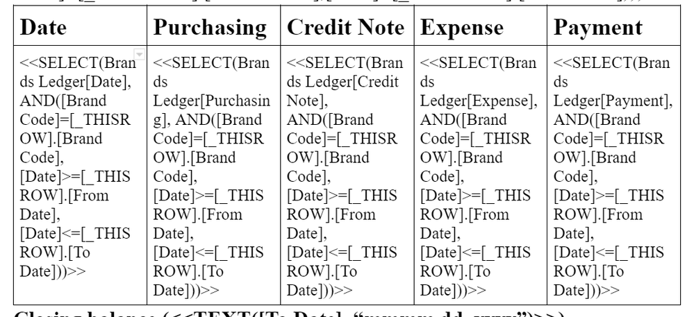

Possibly there should be something wrong with either your template or your <Start:> and <End> syntax. For example is [Date] your Key Column? Can you post a screenshot from your PDF template doc so that we can see the expressions?
Sure!
The table does not contain any child table whose rows are to be shown in the table of the PDF, but the selected rows of the table itself has to be arranged in the table of the PDF.
@Vaibhav_Traders
Your report template shall be constructed like this, assuming that [Date] column is the Key Column of your report generating table:
