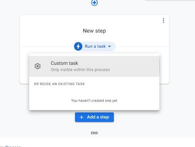

Create a new task not appear
I’m making an automation of a PDF report, but in the custom task, create a new task not appear
Do any of you know what I could be doing wrong?

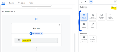

Hi @LuchoSC
According to your screenshot, you have the Linking mode set to OFF.
Your "Custom Task" is the actual "new task".
If you wish to reuse this task, and hence find it in the Automation>Task panel, you need to set the Linking mode to ON.
From what I see, when selecting your "Custom task", you should have the right-side panel open for settings.
More information here:
Reuse automation components - AppSheet Help
