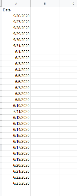

  1. Create a new spreadsheet table called “Dates” that contains a list of dates from today until 2 years in the future. (you can do longer or shorter, just know your app will not work past the last date on this list. I would also create a scheduled action that adds a new date to the bottom of the list each day so you always have 2 years of dates.
  1. In your table where you define the start and end dates, create a virtual column called [Date List] that will be a list with the formula:
select(Dates[Date],and([Date]>=[_thisrow].[Start Date], [Date]<=[_thisrow].[Finish Date]))
This creates a list of dates for that specific record.
