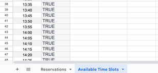

So, I have two spreadsheets. The first one is named "Available Time Slots" and has two columns: "Time Slots" and "Availability". The second spreadsheet, named "Reservations," will have a column "Reserved Time Slot" filled through customer selection from the list Time Slots, along with "Name," "Email," and "Phone."
I want book only one person for slot. As soon a record is added to the "Reservations" spreadsheet the time selected should be unavailable for new registration. Basically just book a time for each person and fill up the basic information.
I guess I need to create an automation or action that change the status of "Availability" to FALSE and somehow create something that will not show this selected time in the list. Whats the best way of doing this? Do I need to add formulas, ref or what?
Attaching some images.
Don't know if the structure is corrected, is there a easier way of doing it?
Captura de Tela 2023-08-18 às 18.13.45.pngCaptura de Tela 2023-08-18 às 18.13.40.png

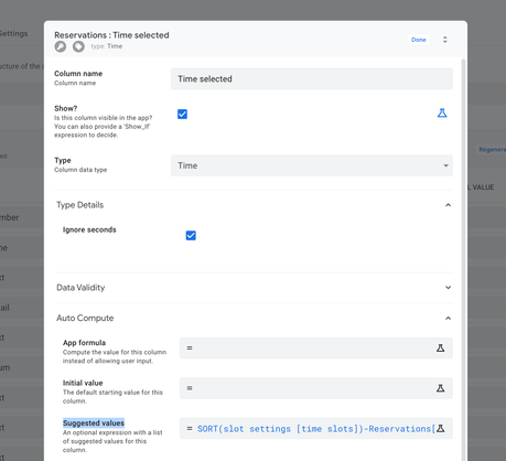

I found a guy from india and he help me with that, it was super simple.
We use Auto Compute, and in "Suggested values" we add this formula:
SORT(slot settings [time slots])-Reservations[Time selected]
So its just showing the time that hasnt been add yet. I add a Format Rule that cross the time that was selected but it's already gone by the time.
