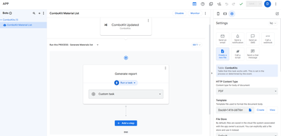

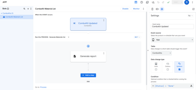

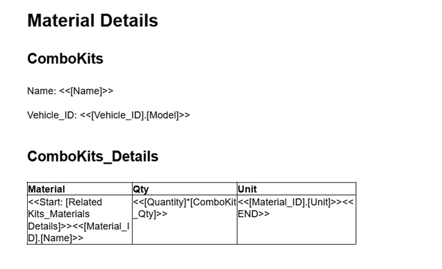

Hi Suvrutt_Gurjar,

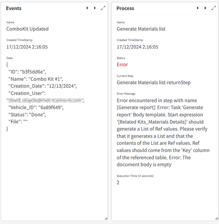

Thanks, I applied the changes and I was able to generate the [Related Kits_Materials Details] column correctly. I generated the template and set up a bot to generate a report whenever the ComboKits table is updated and the status is equal to "done".
Bot setup:
When I tested it,
I got the following error:
This is the template. I checked for any errors in the code and there doesn't seem to be any. What could be wrong?
Thanks a lot for your support! Best regards.
Thank you for the details. Please ensure the column [Related Kits_Materials Details]  references the  "Kits_Details" table. The column's configuration should be something like below

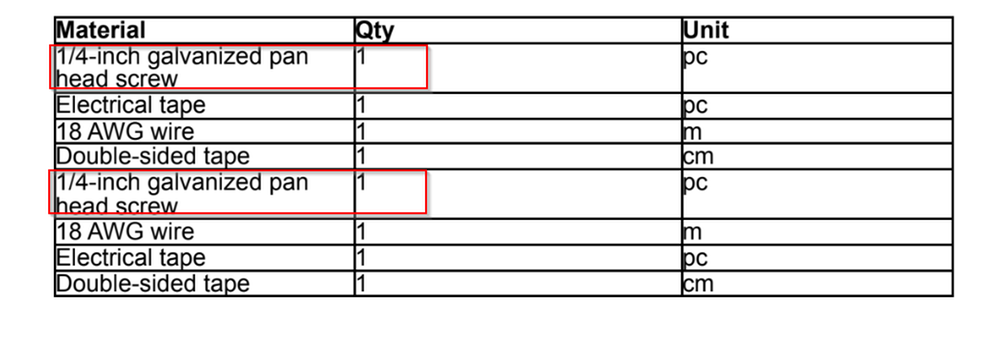

You were right! I had the element type as "text" instead of "Ref". Once I made the change, I was able to download the report.

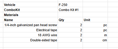

I just have one more question, how can I sum the quantities of repeated materials like the ones highlighted in the image below?
Thank you very much for your support!
Hi @davidAtayde ,
I can give you the approach to compute that addition. In fact I have tested the approach.
However the approach gets convoluted and the columns required will be sync time expensive. I will not recommend using it just for the sake of creating report. I cannot think of a simpler approach.
I may suggest you to simplify your data schema.
If you still want , I can share that approach.

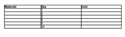

Hi, I've tested the app and it works! I'd just like to add the material name and unit of measure. How can I reference this data in the template?
Here's the current template:
Material
Qty
Unit
<<Start: SELECT(Materials[ID],IN([ID],SELECT(KitMaterials[MaterialID],[KitID].[ComboKitID]=[_THISROW].[ID])))>>
<<SUM(SELECT(KitMaterials[Qty],[MaterialID]=[_THISROW-1].[ID]))>><<END>>
This was the result with the current template:
Thank you for your help!
In your material column and header row, just write <<[Material]>> after your <<Start: SELECT(....)>> formula. Same with the <<[Unit]>> just before the <<End>>

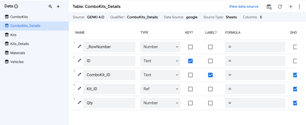

Because you need the ability to give the quantity for your related Kits, you need to have a table between ComboKit and Kits.
I've created the ComboKit_Details table:
I assume I need to create some virtual columns to relate the Materials table to the ComboKit ID, allowing me to iterate through the materials in the report.
Additionally, I think I need to create a virtual column to calculate the total sum of materials in the report. This is because in the ComboKit_Details table, the user can choose the quantity of each Kit to add to the ComboKit.
How can I achieve both of these results?
